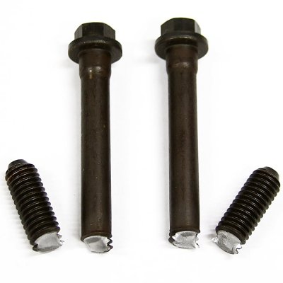

Engine builders are having this issue currently...ARP bolts snapping.

JEWC_Motorsports
S197 Junkie
Aug 22, 2010
20,471
1,596
Texas
The article doesnt say, ARP is blaming engine builders for not using their process to install them. Its across the board manufacturer wise. Lots of ARP stuff is snapping lately.
