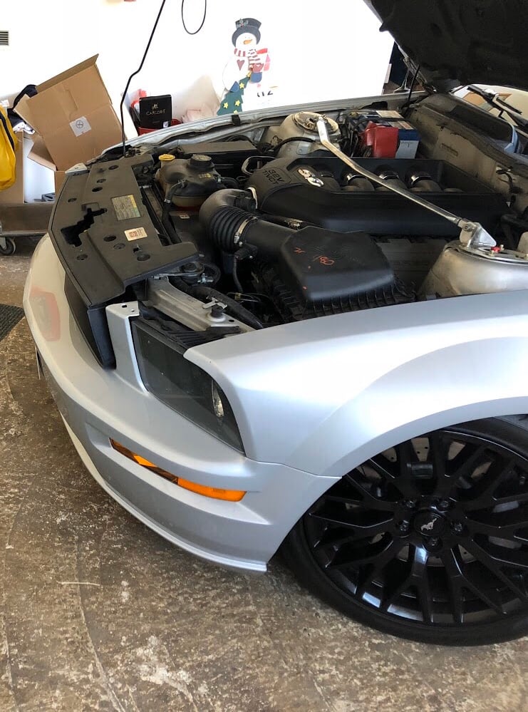

Just saw the topic - if not swapped already, it fits perfectly. Did the 2005 4.0 to 2011 Gen1 Coyote swap last year.
