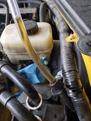

I recently dropped a new 4.6l 3v engine into my 2006 mustang with a manual transmission and it starts up fine, but when I try to put it in gear it wont let me enter any gears while its running(I can go into any gear while the car is turned off). when I try to start it in first with the clutch pushed in it tries to lurch forward. I've spent hours trying to vacuum the air out of the clutch line but that doesn't seem to be doing anything. Does anyone have any tips or ideas to this issue I have run in to?

general rule around these cars is to replace the slave when you replace the clutch, I'd suspect that's the culprit
how exactly did you bleed the system?

If your 145k stock slave was broken it would be a bad seal and fluid would be pouring out of it and onto your garage floor every time you pumped the pedal. You still have air in the system and it sometimes it can be a royal pain in the ass to get out. Keep working on it with a vacuum pump attached to the master cylinder reservoir via a rubber sink stopper from home depot. You will get it out eventually. Look for the youtube video on how to do it.
Another thing could be old dirty brake fluid. Your 2006 is 13 years old now. If your fluid is dirty and black its time to flush it. I finally got around to flushing mine last year. Made a HUGE difference in braking and clutch engagement. Bad and dirty fluid = not enough line pressure to pump up your throw out bearing.
You said everything worked before the motor went bad. If none of it broke when you blew the motor then it should work again. My guess is air in the system (still) or old/dirty fluid.
Another possibility is some of the clutch fingers got bent when installing the new motor. If all else fails and you have to remove the transmission, check the clutch fingers and replace clutch if necessary. Also replace the old TOB/slave since you're already in there. Last thing is make sure you measure for TOB preload before re-installing everything. Your ideal preload measurement you are shooting for is close to 1 inch as possible but not more than 1 inch. There is a thread here on how to measure for TOB preload and shim it up if you don't have close to 1 inch of preload. If you have an aftermarket clutch you NEED to do this procedure. All aftermarket clutch are just a little bit different. Some need a shim. Some need two shims. Some don't need a shim at all. HINT, if you only have 1/2 inch of preload your throw out bearing is only pumping up 1/2 inch. 1/2 inch is NOT enough to fully engage your clutch and take the engine load/torque off the transmission input shaft.

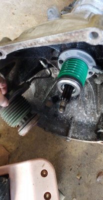

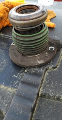

well, I finally found the time to drop the transmission today and it looks like the throwout bearing was definitely due to be replaced. I would think this would be my cause for not being able to go into gear while it was running. what do you guys think? Snapchat-43019452.jpg Snapchat-869197761.jpg

Well even with the new throwout bearing in I can't get it to go into gear while the engine is running. I've tried using the mightyvac to get the air out of the lines but that doesn't seem to be working. Any other ideas? 15513804219119094033424983962644.jpg

Even with bad synchro's you should still be able to force it into gear while the car is at rest and idle. Fourth gear would be the easiest as it is 1 to 1 ratio. Did you inspect clutch fingers when you had everything apart and did you measure for ToB preload? What brand flywheel and clutch are you using? Is it an old worn out flywheel that has been resurfaced a couple times? If enough material has been worn and shaved off during resurfacing that will affect how much extra travel your ToB has to make to properly engage clutch. A couple bent clutch fingers will affect proper ToB engagement as well. Last thing is to check under the dash and make sure the clutch pedal doesn't have any extra play or is "loose" where it connects to the master cylinder push rod.
If everything mentioned above has been checked, the last thing in the system to inspect/replace is the clutch master cylinder under the dash.
