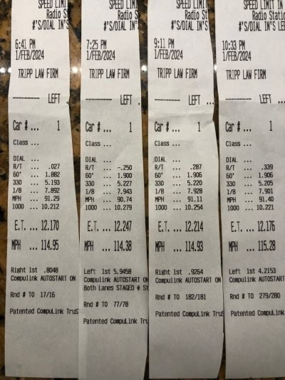

You'll get the best results from the high stall torque converter. The gearing is fine for the automatic. Given the fact that first gear is 4.17, combined with the 3.15 gear set will give you a 13.14 first gear final drive (manual with a 3.66 first gear and a 3.73 axle is 13.65). My 2014 GT with the 6R80 automatic has gone 12.17 at 115 MPH with minimal modifications, CAI, 93 octane tune, FPP lower control arms, and 285/40R18 M/T drag radials. The car still has the factory converter and the stock 3.15 axle.
