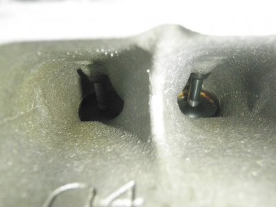

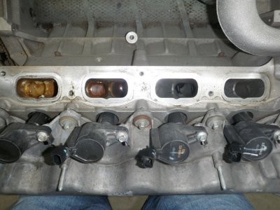

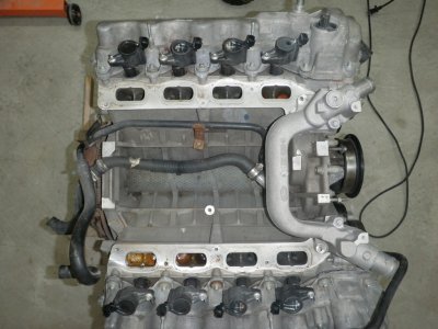

Anyway, I am not really sure what is going on here with my motor, if you have time i would really appreciate some advice. I have a 2005 3v engine, all stock. I bought it from a guy then it sat on a stand in my garage for 3 years. Today for the first time since I bought it I actually touched a wrench to it and started working on it. I removed the intake manifold and looked down into the lower intake runners inside the heads and for the cylinders that have the intake valves closed there is a TON of yellowish liquid/goo in there! A couple runners have about an inch deep of this liquid. Some of the liquid is crusted over like a film/varnish crusty layer with liquid underneath. I can break through the crust easily with a screwdriver, then the tip of the screwdriver is coated in chips of a varnish like film. Could this be coolant? How would coolant get in there, bad head gasket, or cracked water jacket? Anyway, I can see the valves that are open and there is a ring of white deposits, probably carbon?, at the outer rim of the valves. Do I need to yank these heads for clean-up? Can I shop-vac the liquid out and brush/wipe out the remaining without removing the head or am I asking for trouble down the road? Here is a couple pics. Keep in mind this thing has sat for 3 years.....can moisture and condensation build up like this? Anyway, I am probably f'd on this one! If anyone has any advice PLEASE let me know, but be gentle because I suspect this is going to be expensive. Thanks for taking time to read this.

Looks like coolant and oil mixed. Could have a blown head gasket or cracked head/block like you already said. It definitely needs to be torn apart and inspected.

Yes moisture and condensation can build up. Tear it all apart before proceeding or u are asking for trouble later. I couldn't tell u what the hell that stuff is though. Never seen it

Since it sat for 3 years, I would pull the heads off. Who knows what else you will find.

As stated, pull the heads and get everything checked. Appears to be coolant gunk slowly becoming more "gunk" through evaporation ... sometimes folks aren't careful when pulling a motor and dump fluids on the engine ... but why did they pull the motor?

Condensation over 3 years. Did the motor get run over the 3 years or did it sit? Should scope the cylinders for rust.

Another thought is it could have been driven into high water and sucked water in the intake before it came out of the previous car. I would be pulling the heads as others said to inspect further.

With the corrosion showing, the suspicion is that you will have a LARGE repair bill. (I hope I am wrong) If you could pull the heads yourself, would give you a better idea.

JUst an FYI, Varnish is usually gasoline. Does it smell like furniture varnish at all? If it does, then the engine was soaked in gasoline.
I agree. Makes me wonder being that there is a lot more going on in #'s 3 and 4 vs the rest of the runners.

to me it looks like some rust (prob from the valves), calcium from water. I have rebuilt a 5.4L SOHC that had been in an car fire an drowned in water. The ports looked almost the same where water had sat on the valves

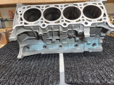

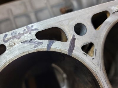

Nothing like following up on a thread 8+ years later! I know so many of you have been waiting patiently each day since 2013 just dying to know how this turned out...........well, I had the engine builder tear down the motor and yes there is a crack on one of the cylinder walls. Thankfully I had another 3V block to build so I'm all set. This block does look good otherwise, I would think it's a candidate to be sleeved and then built. With the coyote being the popular swap are there people still sleeving and building 3V aluminum blocks in 2021? Seems like some guys will spit on you if you discuss anything non-coyote. If no one builds these anymore I'll take this one to the scrapper to get some cash, seems a shame though to not get it back on the road. Here are a couple pics, check out the hairline crack circled in black marker.
