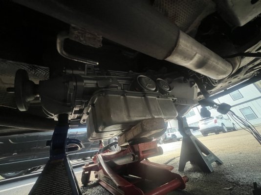

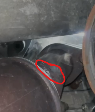

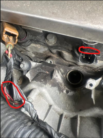

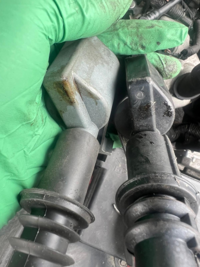

Had my buddy open up the rear of the transmission to take a second look. The 4th and 5th clutch plates looked a bit brown from age but weren't burnt or damaged. Bands were intact, and the servos looked okay. The OD sprag did have a small crack in the cage, but it wasn't completely blown apart, so we weren't sure if that alone was causing the issue. Pictures attached.
After talking with a few other techs, he mentioned it could still be a TCM issue, even without any codes — apparently, they can sometimes fail silently.
At this point, we might just be overshooting by replacing parts and hoping for the best. I've already been quoted close to $3K for a full rebuild, so I'm now leaning toward either getting a remanufactured transmission while everything's out or trying to source a solid used one elsewhere. If anyone has recommendations for good places to get a reliable 5R55S (reman or used) at a fair price, I'd really appreciate it. Just trying to make the smartest move before locking anything in.
