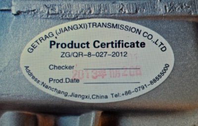

Lots of stuff is made in China. This includes my Brembo Wheels. So why not Chinese tires with my Chinese Brembo wheels and Chinese Brembo brakes being pushed by my Chinese Mustang transmission?

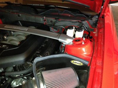

If you are going to be tracking your car and doing 150 then down to 40 three times a lap...I'd suggest you get a separate master cylinder reservoir for your clutch. The Mustang shares a master cylinder with the brakes and clutch, and when the brake fluid gets hot you'll loose some clutch...Just a thought before you head to the track for those 150mph blasts!2014 Mustang1.jpg
