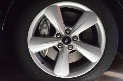

My hand built kit from Rock Auto and Amazon. Rock Auto supplied the Raybestos stuff. Amazon supplied the knockoff calipers and rear caliper adaptor for the GT500 rotors. Total cost was $550. Because the Mustang had very low miles, I decided not to replace the brake lines.
I spent about $510 for my home made kit, but I am using S550 GT calipers ($250 all day from the parts farm), Power Stop AR8184XPR Front Evolution Drilled & Slotted GT500 rotors. $180 for the pair on Amazon, and steel braided lines that were only $80. The brake pads that came with the calipers were still good, but I am getting new pads before I put this build on the road. Add another $80 for new carbon fiber/ceramic pads.

With what wheels? The s550 Calipers are much bigger then the Brembo calipers. Of course my home made kit also included the back GT500 13.8 inch rotors. You just need the adapters to get these to fit even with the base wheels. With the Ford adaptors, you need to pull the axles. With the aluminum bolt on adapters, they just bolt on. With base wheels and the added front Brembo calipers, the minimum spacer needed is 15mm for 3.5mm clearance. The perfect spacer is 17mm for 5.5mm of clearance and the 20mm is really too much.

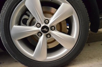

So after 500 mile break in. I do seem to have several issues. One, the back brakes seem to be much hotter then the fronts. One cause might be parking brake drag and yes they are warm in one mile without stepping on the brakes. The fronts are stone cold. Then I have this slight whirling noise I never noticed before with the stock brakes. Thought it was the 20mm spacers in the front but the noise seems to be coming from the rear. I just got some TPMS sensors from RockAuto. Took 10 days to get here for the Brembo Wheels. The Wheels are still something I will move forward on when it gets warm again outside which seems to be Saint Patrick's day around here. The back brakes have a real shine on them and the fronts are still breaking in. I will post pictures later.
