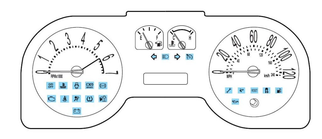

How does your car tell you your gas cap is open???
You don't know there's a MIL for Gas Cap?
Not that color, but that's the basic MIL for gas cap...
The others also get a message on the screen to check the gas cap...

My '08 GT doesn't seem to have either the icon or the message.
Norm
My '08, as soon as I start it, it illuminates for a few seconds with the
wrench, and the other lights that normally go out. I suppose the
GT doesn't have it, but there is supposed to be a warning of some sort.
GT - The sequence of the system check report and how it appears in the
message center is as follows:
1. OIL PRESSURE
2. CHARGING SYSTEM
3. DRIVER DOOR
4. PASSENGER DOOR
5. TRUNK
6. SECURITY SYSTEM (if equipped)
7. BRAKE SYSTEM
8. ETC SYSTEM
9. TRAC CONTROL (if equipped)
10. FUEL CAP
11. FUEL LEVEL
12. MILES TO EMPTY
CHECK FUEL CAP. Displayed when the fuel filler cap is not properly
installed. Check the fuel filler cap for proper installation. Refer to Fuel
filler cap in the Maintenance and Specifications chapter.

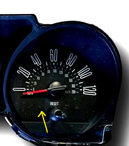

WTF, speedo only goes up to 120 ! I think I know what the problem is..... you are missing 2 cyls.
