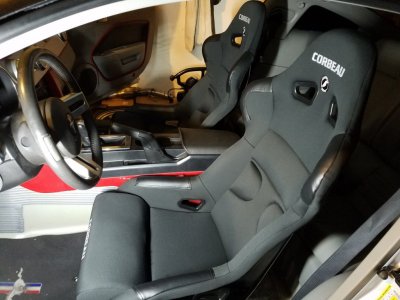

Has anyone installed an FX1 Wide seat into an 05-09 Mustang? Searching reveals plenty of talk about the standard and Pro versions of this seat.
Based on the provided measurements by Corbeau, it doesn’t appear the Wide version will fit, but would like to confirm.

Im about 5' 6" tall. I have a FX1 Pro and when scooted forward the inner side rubs the center console. I dont really think a wider seat will fit. Maybe if you are tall and seat is scooted far back but still seems unlikely.

I ran the middle width seats from Corbeau, they pretty much fit perfectly. Any wider is prolly a no-go.

This is with the FX-1? Just want to clarify, because if so, then yea the wide version won't fit.

Sorry about the mix up but I just reviewed the seats I ordered and I have the FX1 standards. Not the pro

No worries, thanks for clarifying. That means the wide version likely won’t fit.
I’ll just order the standard model and lose weight. Easier said than done!

The middle width FX1 seats fit our car perfectly, the standard is MUCH more narrow. The widest version may not fit. The middle width seats fit a 38 inch waist with room to spare, I'm on the wide side compared to other guys in a 38 so if I am conformable in those seats a littler larger waist would fit fine.

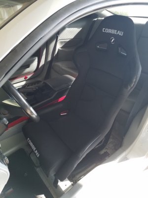

Are you wanting a fixed back or a reclining seat? The only relevant experience I have with your question is that I'm similarly sized as you and fit real well into a Corbeau Forza Wide. Comfortable for longer drives, but a pain to get in/out of. That's why I'm buying an FX1 - it has a lower side bolster to make ingress/egress a little bit easier.

If you're looking to loose the most weight you will need not only the right seats but the right mounts. The corbeau seat mounts for the seats really add some weight. Around 12 lbs if I remember correctly. It's been a while since I weighed them. Fathouse Fabrication makes some sweet adjustable mounts that are very light but pretty pricey for just seat mounts. Going with FX1 and Corbeau mounts youu save almost half the weight of stock powered seats. With a Kirbey or Jegs aluminum seat and Fathouse Fabs mounts you will lose almost another half of that.
Aluminum seat and Fathouse fab adj mounts for weight
FX1 and corbeau mounts, or maybe custom for comfort.
I enjoy the fit and comfort of the FX1. Nice seat for sure
