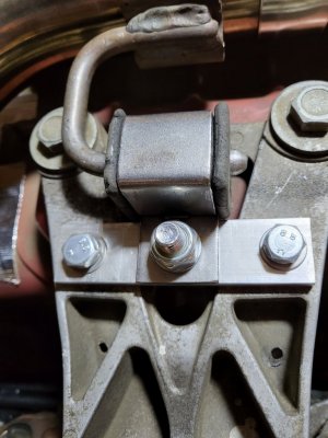

I'm in a similar boat. I've been chasing a rattle/buzz at about 2050-2100 rpm on my car forever, or at least as long as I've had the urethane motor mounts on it. I recently read about the TSB and got underneath, and sure enough, the pipe mounts rattled when I banged on 'em. Out came the die grinder, and 20 seconds later they here history. However.... Mr. Genius here (me, that is) didn't consider the flex joints I had installed between the pipe mid-mounts and the x-pipe/tailpipe connection.. Without the mid-mounts the whole system sagged way too much. Now I'm reworking the mid mounts. I have a couple of universal mounts that I might try to fit, or I may just go to ebay and get another crossmember (there are several on there).

Here's what I did with mine this weekend. Used 1 x 1/4" aluminum flat bar bolted to the crossmember with M8 x 1.25 bolts after drilling/tapping the crossmember. The center stud is an M10 x 30 wheel stud pressed into the flat bar. Hanger is a Walker 36518 with the outer part of the mounting tab cut off.
