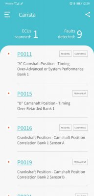

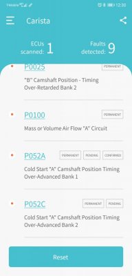

Can anyone advise what repair needs to happen? I've already budgeted for an engine swap as worse case, but any other diagnosis here will be helpful if I can save some money.
Also have a bunch of error codes I've recorded from my scanner, attached as images.

Initially sounds like VCT issue with a cam phaser/phasers. Given the codes that would be the first place I would focus. It sounded louder from the top than underneath as well and similar to the tone I heard on my former 2005 when it lost phasers...though I did not have codes. Regardless of the differences in the engines VCT is VCT. The coyote has four of them where as the 4.6L SOHC only had two. Shen the cams phasers fail interference between the valve and the piston dome occurs.
How many miles are on the car? What mods does it have aside from a tune and CAI? Perform a compression test on all 8 cylinders. Also as stupid as this may sound, you could try doing an oil change to make sure some numb nut did not put some high viscosity oil in the engine which can cause the VCT system to not work properly though it clearly states 5w20 on the oil cap and in the manual. There are also little filters on the Coyote VCT system that could become clogged and cause this as well.
