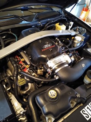

    Hey there fellas I just wanted to get yall's thoughts on these 2 upgrades and if they are worth the money. Now that we have the cams and cai installed, would either or both of these give any improvements? My boy also wants to install some lth's in the near future and I know those will help wake her and...and the neighbors lol. Thoughts? TIA

    worth the money? That's debatable. What is your goal? If you're looking to make 400+ to the tires, don't waste the money on the mods you are looking at, just get an SC IMO. If you're not looking to make that much HP, I would get the LT's first, I don't know for sure, but I'm thinking the gains from the throttle body will be zero, and minimal for the intake.

    $1300 cost to buy the FRPP intake manifold with 62mm TB, plus $150 tune all for a mere 13rwhp gain? You decide.
    IMO there are much better ways to spend that amount of money e.g. upgrades to suspension, tires, brakes, appearance mods, your boy taking an advanced driving course.
    Long tube headers are another one of those mods that don't deliver much bang for the buck unless you find them used (or new but cheap) and it's a DIY installation. If you were to buy $1200 headers, pay $800 for installation, and $150 for a tune, that's $2000 for a mere 16rwhp gain.
    If you combine the cost of the FRPP intake manifold, 62mm TB, and LT headers which would only yield ~30rwhp, you're already halfway towards buying a supercharger or turbo kit that could yield ~150rwhp. Food for thought.
