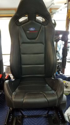

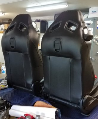

So the latest FRPP Recaro Seats P/N: M-63660005-ME are designed to fit the s550 not the s197. After doing a little research I've learned this is not a huge deal. I have a plan and in the end it'll be totally worth it.
I want to give a huge thanks to Scott and Steve@Tasca!
These seats are well crafted and look freaking awesome!
I'll be sure to document the complete install...
For now, enjoy some photos....
Making room for the new seats..
Surprising these survived shipping as the packaging was less then sufficient...

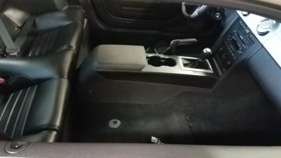

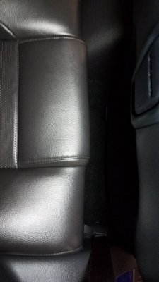

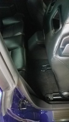

If you move the seats All the Way Forward you'll likely have enough room for a small adult or a child to fit but it will be tight.
This picture was one taken with the seat all the way back I'll try to get a photo with the seat all the way forward.
