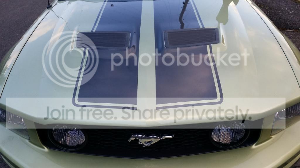

Love seeing the hot air escape at stop lights causing a mirage effect on the TR Hood.

Damn straight, it gets a ton of attention. The hood is the first piece of the car ppl ask about

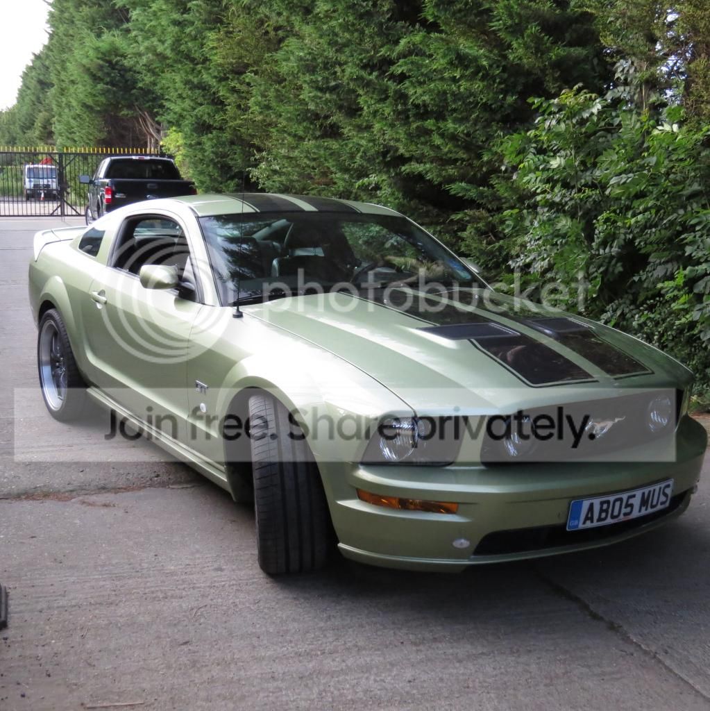

just stumbled across this thread - does puzzle me why more people don't do this...
as it's OEM Ford it bolts straight on, no cutting or specialist fitting needed - job jobbed as people say

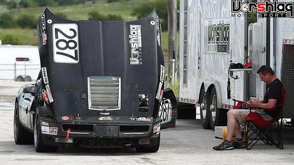

We've seen these "heat plume" images on other hood designs as well.

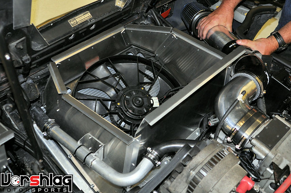

This effect is even more pronounced when the radiator has a duct box sealed to the hood.
Making this is very time consuming and beyond the fab skills of most folks. Its appropriate for race cars but not really for street cars.
Just adding something like the the TR hood helps, and is much easier than making something that is sealed to the radiator, rolling the radiator, etc.

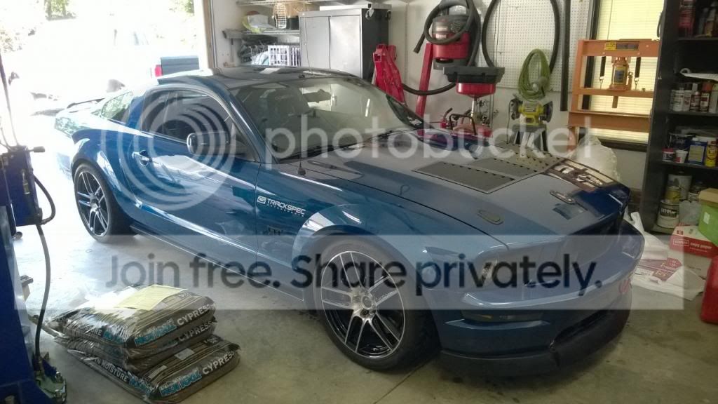

Whoa...your car looks great.
Is that the fiberglass Tiger Racing hood? Does it do ok without hood pins?
kdaly1
Apr 7, 2015
14
Thanks man, I've spent a lot of time trying to tastefully customize it to my liking. And yes it is the Fiberglass version. If I were to do it again I would have gotten the CF version as mine cost more in prep work for paint than the original cost of the hood shipped to my home. I see very little shaking. Its almost like flexing as the hood is susceptible to that. Nothing concerning tho and I've had it 100+mph. Hood pins are never overkill tho for this hood. I may do it in the future but as of now, nope. Next thing if I decide to push the project further would be a MaxMotorsport cage and a built motor with clutch.
