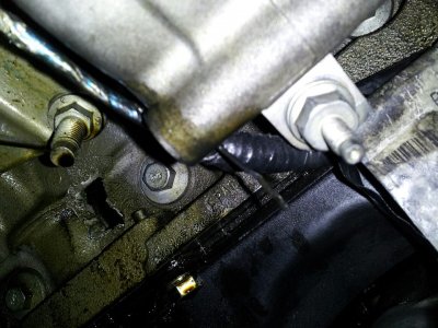

This is how they handle it
you mean this is how
I mean technically this was turbo'd not sc, and untuned, and wrong fuel, and wastegate backwards, etc etc....but still funny
