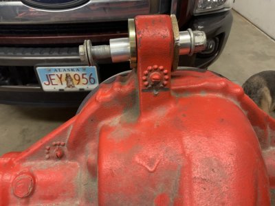

    All this talk of laud differentials. I installed this
    And a set of these
    And now it sounds like there is a dump truck in my back seat. Is that normal?

  9. Mach2burnout
    Mach2burnout 05 Redfire GT
    4,266
    496
    Yes, when you install heim joint fittings where rubber originally was, your gonna get noise.

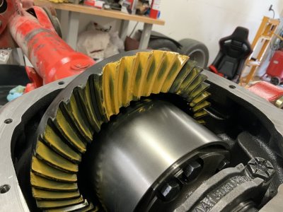

    You might try removing ring & pinion. On small 90* air grinder and using a 2" dia. 80 grit disc chamfering all edges on both the R & P removing the sharp corners which I think might be causing the gears to scream. I am planning on doing this on my 06 GT but haven't gotten around to it.

  12. Midlife Crises
    Midlife Crises Senior Member
    1,117
    677
    If you look closely you can see that the sharp edges were removed by the manufacture in the polishing process. I don’t know what more could be done in the sharp edge area. The gears don’t engage heavily on the edges.
