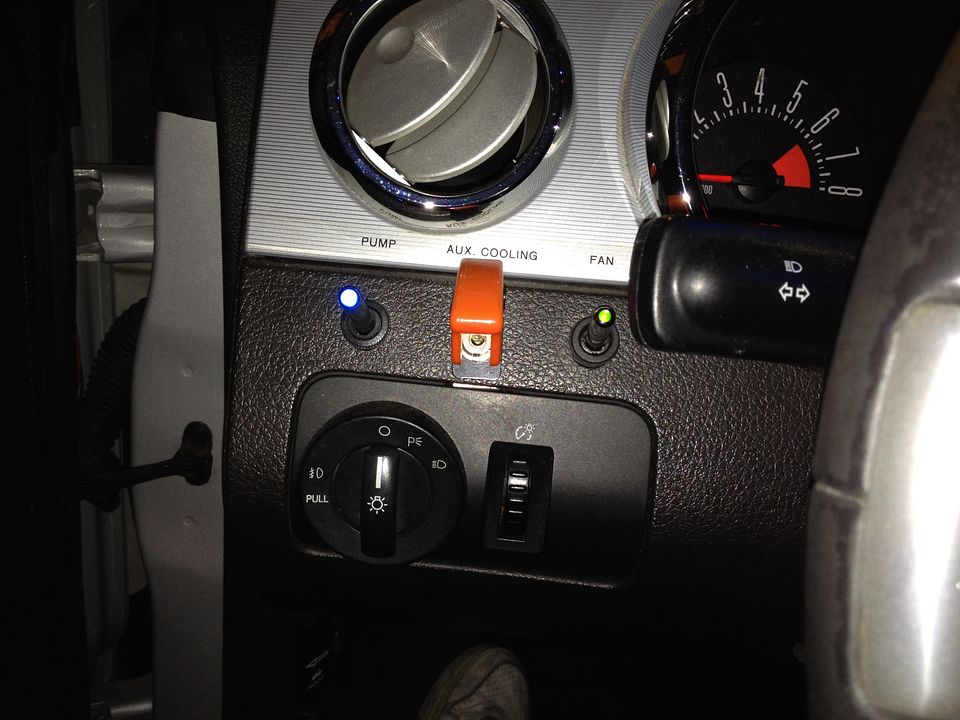

I know you want to keep the factory look but if you can't get another switch panel in there you can add some switches without it looking too bad.

Not the prettiest solution
And this is the reason I'm even putting in all that effort because that is the exact opposite of what I wanna do.....
