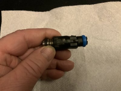

So I have a 2007 GT w the m90 blower. It was on the car when I bought it so I’m under the impression that i still have the 38# injectors that come with the kit. I upgraded my upper pulley and my tuner said my injectors are MAXED OUT like at 128% duty cycle. Anyway , I need bigger injectors but I was told the m90 kit uses a smaller type of injectors. I was going to order the gt500 52lb injectors because I was told they use a short injector as well , will those fit ?? And if not what fits ?

I'm going back a decade and my memory is like swiss cheese, but I believe I used 52mm GT500 injectors after upgrading my blower on my M90 setup (taken off a 2010 Roush 427R). Back in the day there were a half dozen of us with that setup on this forum.

Do you mean 52lb? Unfamiliar with ”52mm”

I’m running the 52lb injectors that came with a stage 2 R2300TVS kit. You may well need to repair or upgrade your fuel pump/wiring. I’m using the GT500 dual pumps and wire upgrade to feed those injectors.

Do you have a part number or link for those specific injectors? Idk which ones will fit with my m90 blower. I have a dw400 fuel pump I need to install. Rated for like 800 hp
