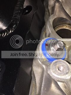

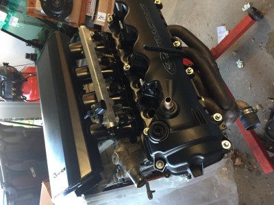

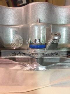

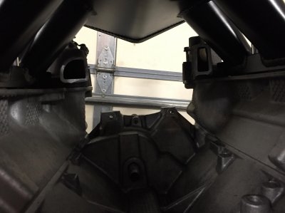

If you were to install it with a IMRC delete plates it's plug and play but the hood will not close. If you install without the plates the intake runners 1 and 5 hit the water neck crossover where it runs behind the Alternator from head to head. Also the intake hits the cylinder heads in the middle where the manifold mounts to the heads. This issue was easy to fix with little grinding. The water crossover was a little bit more involved.
Here is where the intake hits the heads:
Here is the fix:
I had to cut the water crossover tube and weld it closed:
I don't have a pic but after I welded it closed I drill and tapped a 3/4 pipe tap hole and used AN lines to make the connection from drive side to passenger side. The VAC routing issue is really a none issue. I had to extend 1 vac line 6"

2 little things. 1) We need pictures of the finished product and 2) We need numbers!.... I'm happy you showed a fix to this but the question is "Was it worth it?'

Will a 3/4" line flow even close to what that crossover once did? Must not be a big deal.

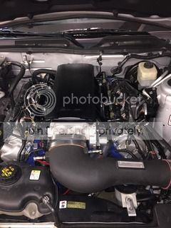

I kinda did the same thing. This is a killer build. Pt8285 with th400 and Holley EFI. Looking for 1000+ on e85 and 26-28lbs. Gonna be light car too
It's bullshit this intake fit like shit. Worst I've ever seen. But it looks so dang cool

The 3/4" pipe I'm using measures 7/8" ID. I agree after looking at it again I'm concerned there isn't enough flow. I'm going to make some adjustments. I'll post up pics later today.

Yea thats small, standard for engine coolant lines is -22 or 1.375" ID. I would at least want to be in the 1.25" range.

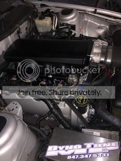

So here is what I ended up building. 3/4 pipe in back .850 ID and 1/2" pipe in front .625 ID. Total investment $50. I paid less than $425 for the intake with rails on a black Friday sale.

Is the juice worth the squeeze? I'm not sure at this point.
I had to grind a little on the back of the TB to get it to mount flush against the intake. Hooking up the vac lines and the fuel lines were pretty easy.

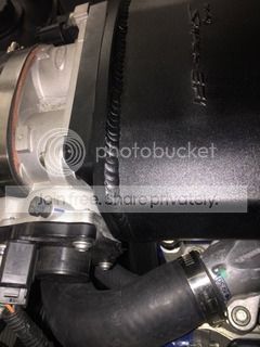

The car started right up but there is a god forsaken noise coming from the plenum. The large flat surface area on the top of the intake vibrates making a hollow / tinny noise. Rest your hand on it at it goes away instantly. Remove your hand and it's back.
It must flow a little more air as it thru off my SHFT trims by about 10%. It ildes good and after about 50 miles I can say it drives fine however the noise is killing me. My car is a true sleeper. No heads or loud exhaust and the twin turbos muffle the fact there are no cats on the car. I can hear the noise while at cruz or at idle and it bugs the hell out of me.
The solution would be to weld a 1/4" thick x 1" wide aluminum rib down the middle of the intake to braces the big piece of thin sheet metal then have the intake powered coated again.
At this point even if it made an extra 50hp I'm just not sure the juice would be worth the squeeze.
