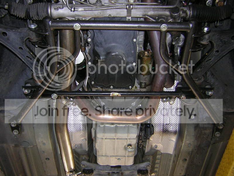

Yesterday I was talking with the guys at my local transmission shop and we were discussing the motor mounts. Because the issue started immediately following my install of the BMR K member, a couple of the guys thought that was the problem. I decided to call up BMR and ask for some advice.
Kelly happened to answer the phone and I had a great conversation with him. He also said that the CHE brace sounded like a good idea, but he also said that it didn't sound like a torque issue to him. Peak torque is at 4250 rpm and the shifter works perfectly up to 6000 rpm. If engine torque was the issue then I would have lockout at lower rpm as well as in other gears. He said that he's wrecked at least 10 Tremec 3650 transmissions and each time it only took one hard missed shift and it never worked right again.
That would be consistent with my experience, I did knock down my best time in early January after installing the K member a week before. And two passes later is when I had the 3rd gear lockout for the very first time (I have the time slips right here in front of me). It's never been right since.
I may hold off on modifying and installing the CHE brace for now and have my transmission guy open up the 3650 first. If it's a synchronizer then the brace won't help.
