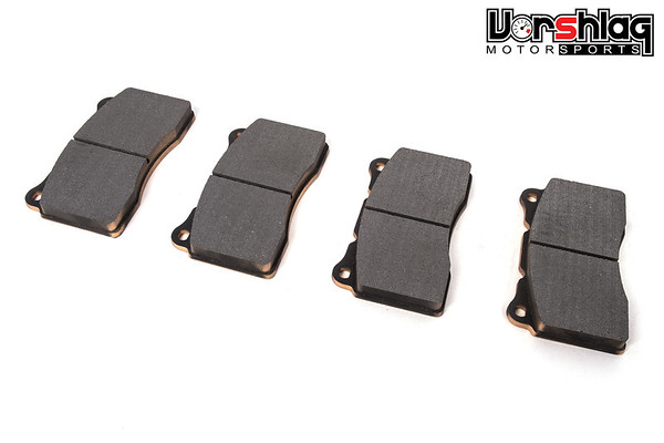

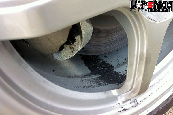

Don't expect any pads that ever came on an S197 from the factory to be worthwhile at a track event, unless you are driving at 50% or less of the car's potential. And that happens in some cases, but most folks can cook the OEM pads quickly. I've taken brand new factory pads down to the backing plates in less than 10 minutes of hard track use. They got so hot they crumbled and fell apart...
Track worthy pads have a higher heat tolerance, higher friction coefficient, and all will make more noise and duct than the OEMs would allow for stock pads. They also don't work well when dead cold, so panic stops when first driving are compromised. This is why brake pad manufacturers recommend not using them on the street - to cover their butts if someone rolls through a stop light on dead cold race pads. With some forethought it isn't a big deal, but they like to be safe.
http://ctbrakes.com/brake-compounds.asp - Carbotech brake pad compounds
The difference in a good "track pad" vs a street compound or even an autocross compound brake pad is dramatic on track. If you do NOTHING else to your S197 before going out on track, put in good brake fluid and a set of track worthy pads. Swap them at home before your event and swap back to your "daily driver" pads when you return. With Carbotech brand pads we skip the 1521 (street pad) and the AX6 (autocross pad) and go straight to XP10 front and XP8 rears on a 14" Brembo equipped S197, at a minimum. As your speeds and grip levels increase you could end up moving up the scale...
On our 3770 pound TT3 Mustang we've moved up the compound scale to XP20 front and XP16 rear compounds, and get excellent heat resistance, wear and braking power. That's a fairly extreme pad and more than most Mustang folks need by a long shot, and it does make a LOT of dust and a LOT of noise. I've also been able to get them to "glowing cherry red" in daylight conditions and still had excellent stopping power and longer brake pad replacement intervals. I've tried a dozen brands over the years and I finally found one I can trust.
The one other clue to a pad's track worthiness, beyond a claim of "don't use these on the street!", is the cost. The lower cost brands of brake pads use a lot of FILLER MATERIAL, which turns to goo and allows the actual brake pad compound to come apart in high heat situations. I cannot count how many sets of Hawk and other brands of "lower cost" pads I've taken off of my cars and had them crumble and break apart with 3/4 of the pad material left. The old adage applies to brake pads: "you get what you pay for". The more respected, more expensive brands that you see on race cars tend to work better and last a lot longer on your track car also: Ferrodo, Pagid, Carbotech, PFC, etc.
