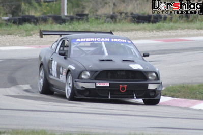

The black '13 GT, however, needed much more track prep help - but we only had one day to do it, with the sudden change of schdule on our E46 BMW. While the '13 started out life 45 pounds lighter than the '11, it was much less equipped, and missing the much-loved 14" front Brembo brake package - which also includes wider wheels, and different shocks/bars/springs (we think). We had planned on taking our 2001 BMW E46 330Ci to run at ECR in the TTD class, but our painter needed more time so the car wasn't going to be ready, so we hurriedly put the 2013 GT into some sort of track-ready form.
It was still bone stock, with the craptastic 235/50/18 all seasons, 18x8" wheels, stock non-Brembo brakes, stock pads/brake fluid, and stock base GT suspension (which I think is different than the shocks/bars that come on the Brembo equipped cars). I couldn't bare to run this car this stock, as it would shred the tires and be laughably slow, so we threw some parts at it on the Friday before the event. A set of Vorshlag camber plates took the front camber from 0 to -1.7° (with lowering springs the max negative number is closer to -2.8°), threw the old Eibach front bar from the 2011 on, and slapped on a set of our Vorshlag 18x10" wheels and that old set of 295/35/18 Nitto NT-05s that I ran at the Optima Challenge.
As you can see, switching from the skinny 8" wide wheels and 235mm tires to the 10" wide D-Force wheels and 295mm Nittos actually helped the car lose over 27 pounds of unsprung weight/rotational inertia. That is a huge win, but the +60mm of tire should add more grip, too. The crew here tried to convince me to get a set of track-worthy pads for the '13, but I veto'd the idea, as we are chucking the whole stock brake set-up into the trash very soon and I didn't want to waste $300+ on track-worthy pads for a single event. I said "Hey, they are 13" front brakes, how bad could they be?!" I also blew off flushing out the stock brake fluid with some better Motul RBF600 that we stock and sell. Turns out those were two crucial errors in judgement on my part...

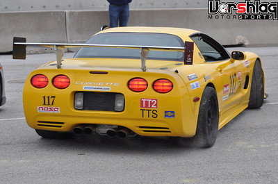

Let me back up a second - before the Saturday TT event even began I heard about a fellow TT competitor that crashed coming out of Turn 4 on Friday's practice event. A little tank slapper off into a 2000 pound hay bale that pretty much totaled the right side of this EVO X. So that's two totaled cars in two weeks from local Time Trial competitors - the Mustang at GTA and this EVO here. That sucks, but this is what can happen when you track a car at 10/10ths (or 11/10ths?) Don't forget the potential consequences, and don't short change your own personal safety. Luckily this driver also walked away unharmed, just lighter in the wallet. :(

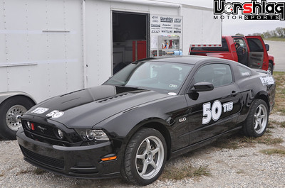

How About the 2013 in TTB?
Yea, about that. Well we had nobody there shooting pictures for us all day Saturday, so I don't have any "action pics" in the '13, and with only one video camera we didn't get in in-car vids of the '13 either. That's probably all for the best, as it was pretty terrible on track. I cannot describe in words how awful this car turned and braked. It was rather remarkable. Sure, the 5.0 Coyote V8 made boatloads of power, and the NT-05 tires worked "OK" in these frigid conditions (finally didn't overheat!), but the brakes were atrocious and the handling is best described as "boat like".
ECR is a little bumpy. OK, it is a lot bumpy, but with good shocks on our various track cars (ASTs or Motons) we don't notice the surface humps, heaves and bumps at this track almost at all. This 2013 GT was on the OEM shocks, and I'd swear they were 200,000 mile blown shocks and struts if I hadn't seen the odometer reading 600 miles with my own eyes. The front end was porpoising up and down about a foot all down the back straight. Even the corner workers we talked to at lunch remarked at how bouncy and floaty the car looked. First session best time was only a 2:10, but that session doesn't count for times.
Even with maxed out camber, which did help me from shredding the outside edges of the front tires, this car was a hot mess. Like driving a guided missile - all kinds of power, but with minimal turning and no way to stop. The handling was like this: it would turn in, then keep rolling, then bounce through the corners and flail around, seeing both top and bottom of suspension travel several times per corner. Just awful. The base GTs must have a set of noodle shocks and springs. And we even had an Eibach front bar set at full stiff, to try to fight this massive bodyroll. And big 295mm tires on the thing, up from 235s. It was all "lipstick on a pig" with the stock suspension, though. This car needs better shocks and springs BADLY.

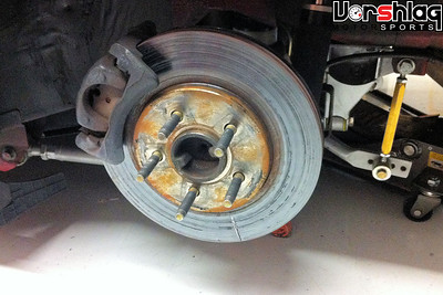

By TT session 2 the base GT's 13.2" front brakes were going away quickly, and by that session I realized the brakes only had ONE hot lap in it at a time, then needed a really slow cool down lap to get the brakes to come back. I was braking the '13 a solid 50 to 100 feet sooner than in the '11 but it was still barely staying on track. And one time, it uh....didn't.
I was coming down the back straight in TT session 2 at what the (second, borrowed) AIM Solo later said was 115 mph. I go to brake for turn 7, down shifting from 5th to 3rd... but there were no brakes. Pumping madly, nothing happening. I could say I was still "getting a feel" for the stock pads and braking system but I was abusing the crap out of the car, to try to make better lap times due to the abysmal handling. It was too much and the front brakes just didn't have anything left. I won't blame the equipment, because I bought the car on purpose without the Brembos, then left the craptasic stock pads and fluid on there, then over-drove it; I have to blame myself for not having the forethought to replace these critical OEM bits + the extra abuse I was laying on the car.
So in TT session 2 on Saturday I went WAY off the end of the back straight, still doing about 80 mph, even though the entry speed is about 50 mph (according to the data I was doing 123 mph and slowing down to 51 mph in the '11 GT - lots of braking). The corner workers had a good laugh at lunch. "We thought that car would never stop!" I was a good 100 yards off in the dirt, but the tall and soft 4x4 stock suspension at least soaked the off-roading up well enough. Only evidence was a little stalk of grass in the grill, and otherwise zero damage. I got off lucky.
Turns out the front brake pads were done by the end of TT session 3, as shown above. Went from brand new full depth OEM pads to a hair off the backing plates in three sessions. Half of the pad material seems to be sitting there inside the front wheels, where I parked after coming off track! Since we had no times in TT session 1, and I earned a big fat DSQ for TT session 2, I had to go out and nail down something in TT session 3. Surprisingly, with much attention paid to the quickly fading brakes, I nailed down three laps in the 2:07s with a best of 2:07.33. By then my nerves were as shot as the brakes and I changed my role for the rest of the day to "Amy's support crew". I finished 3rd out of 4 in class, well behind KenO's 1:58.678. Oh well, not very shocking... since the car had no shocks! :p
