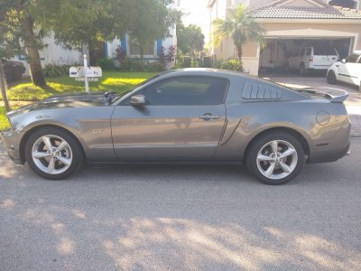

I have the 255/45-18's on the back and they fit very well. No bulging at all. I was reviewing the Goodyear website and I was rethinking to 235/40-18's for the front. Obviously this varies pre vehicle but their chart says that all these tires are compatible with 8 inch rims. What do you think about the 235/40-18's for the front? The diameters would be 27" on the back and 25.4" on the front. That way the rear tire doesn't look taller. I attached pics of my car. As you can see the front stock tires look taller than the 255's on the back. The side view not as much but when you see it in person the fronts look taller. Once again, I appreciate all of your replies. You guys are helping me a great deal!!!

I have the 255/45-18's on the back and they fit very well. No bulging at all. I was reviewing the Goodyear website and I was rethinking to 235/40-18's for the front. Obviously this varies pre vehicle but their chart says that all these tires are compatible with 8 inch rims. What do you think about the 235/40-18's for the front? The diameters would be 27" on the back and 25.4" on the front. That way the rear tire doesn't look taller. I attached a pic of my car. As you can see the front stock tires look taller than the 255's on the back. Once again, I appreciate all of your replies. You guys are helping me a great deal!!!
Trust me, it bulges (by a little more than 1/2" on both the inside and the outside, and it's obvious enough to me just looking at your picture that they bulge). All minimum-recommended and even "measuring-width" wheel to tire fitments do. Don't use what the OE tires and wheel fitments on standard sedans, SUVs, crossovers, or pickup trucks look like as a reference for what a performance wheel & tire fitment for a performance car should look like.
