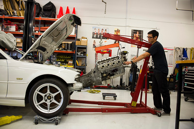

This is an oft asked question: How do I swap my V6 (enter car here) to a V8 of the same model, which the factory also offered?
Answer: You don't
Honestly, the only "swap" here that isn't a HUGE waste of time is to: take any parts off of your V6 Mustang that you like and sell it. Then buy the V8 version of the same car, swap on the usable parts from the former V6 car, and save yourself HUNDREDS of hours of frustration and pain, and potentially thousands of dollars in parts / work.
This 2010 Mustang GT 4.6L we swapped to Gen II Coyote 5.0L was a LARGE pain in the ass...

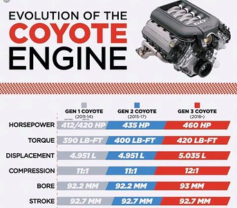

Seriously, this is not a smart swap to do... The 4.6 3V isn't even that good of an upgrade (300-315 hp vs 420-460 for Gen I-III Coyote 5.0L), and when the factory made the exact setup you want this is just a bad idea. Sell what you have / buy what you want and you are miles ahead.
And this is coming from a shop owner who has V8 swapped 13 different car makes/models and has delivered 500+ V8 swaps for the past 20 years. I doubt if anyone else on the planet has done more modern V8 swaps / kits than us. So maybe I know what I am talking about here: you are just wasting time.
Unless you are building some hybrid engine swap that never came from the factory we always REFUSE to do the swap work like this - because you can just go out and buy one of hundreds of thousands of S197 4.6 3V cars used and it will be a BETTER swap than you could junkyard / home brew.
