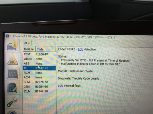

john knox
Sep 7, 2020
16
try forscan.org software the ecu ctl all of it, see in the pic no mil lamp, but ecu was smoked ran like shit, if your going to own mustang get this software
