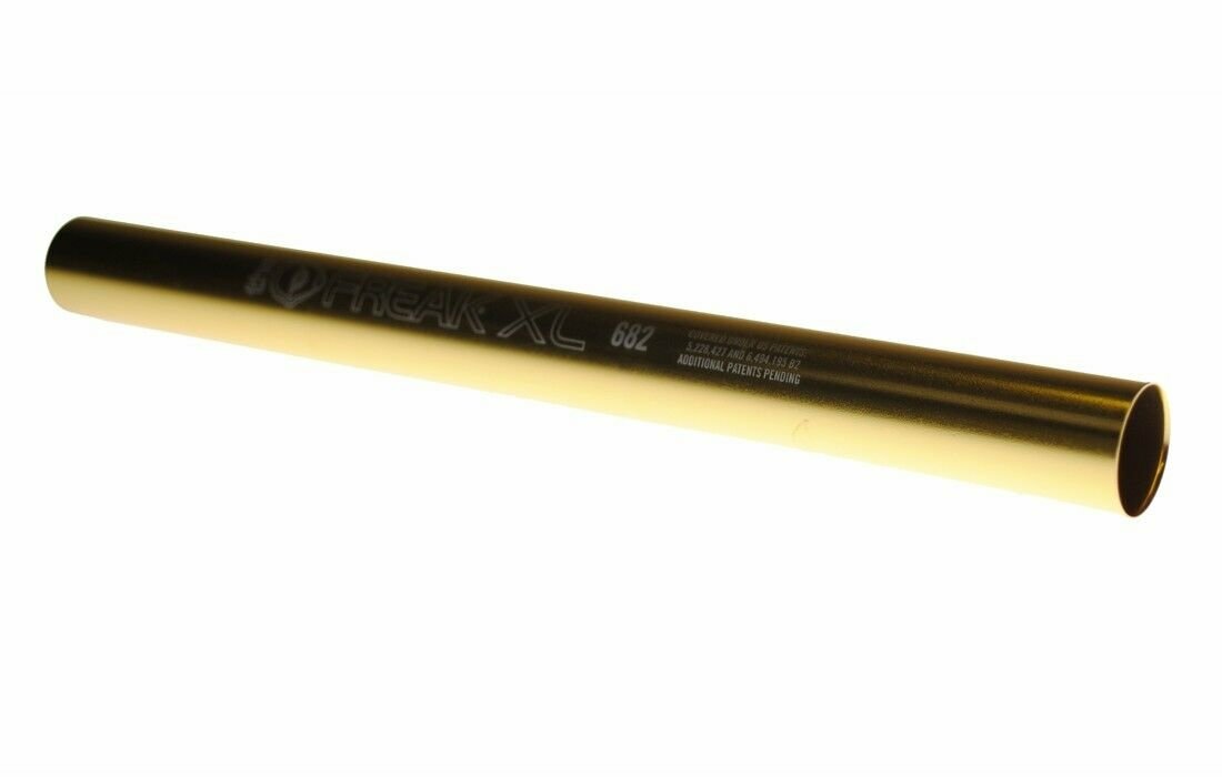

Nice little fix courtesy of the paintball industry
Before
After
Just enough clearance to spin freely in the hole. Love it!

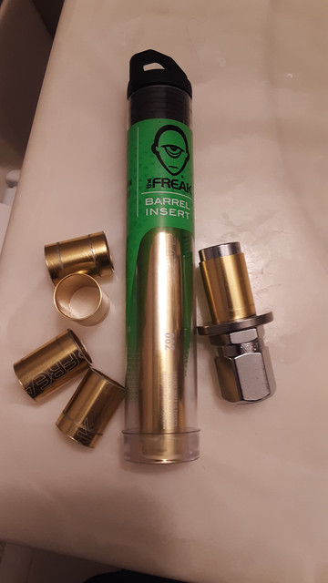

Yes those are the good ones, little skinny but should work fine as opposed to the other lugs made of play-dough.
I didn't like the gap between the lug and the wheel so I made some spacers.

So I got the good McGards and the racestar shitlugs, both have play in the hole for the lugs. McGard has a bit more.
I am going to make some sleeves to take up that space, my OCD won't let me run them like that.
Kinda feels like I am creating a big impact wrench out of the wheel with the amount it moves around the lugs, I can't image that is great for hard launches.
No bueno and a bit disappointed in the loose tolerances with these wheels.
Yup, I am aware everyone runs them like that just seems shitty. And pretty sure I can do something about it.

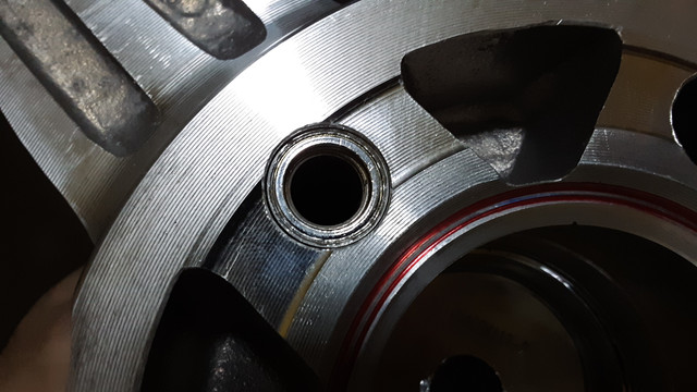

Don't they have a conical end on those? The shape of the lug end centers the hole over the stud. Play between the shank of the nut and the wheel does not hold it on.
No it definitely does not you can wiggle the lug in the hole all you want.
Pics below...
Pics below...
Yeah, but once you put it on a stud and torque it down it will center itself. That's the way it is designed. The shank of the lug does nothing to hold the wheel in place and there is no play when they are torqued properly.
I just don’t see how that is possible, the end of the lugnut just has a washer on it that sits flat against the wheel. There is nothing to center the actual lug in the wheel, the face of the hole in the wheel is flat. And so is the washer that goes around the lugnut. Maybe you have a different wheel?
The wheel when all lugnuts are in and not tight yet can be clocked back and forth (when the sleeves I have are not in) because of not filling the hole up enough. As I’m sure you can imagine that’s a do it yourself impact wrench smacking your lugs when you launch hard on slicks.
My Race Stars use washers that center the lug. I thought we were talking about Race Stars and replacing the lugs for those.
If you are using washers, are they not asymmetrical? Don't they sit in some kind of recess or tabs? I have washers on my old Cragar SS wheels and they center the lug in the hole. I only know of 3 kinds of lugs for wheels. Conical, Ball and Mag. The conical and ball use the shape of the bolt to center it. Mag style lugs use a washer to center the lug. In my 39 years of driving and wrenching on cars have I ever seen a wheel that allowed rotational movement of the wheel while it was bolted on.
Can you post up a pic of the front face of the wheel showing the holes for the lugs?
