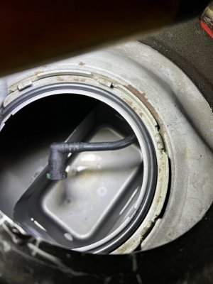

Let’s look inside the tank. EA41A7C3-F1A4-449C-85E6-86ECE7430C9D.jpeg 34E05C61-3C40-4054-81E5-71878FD5AE41.jpeg
The top photo is the drivers side. The bottom is the passenger. The black hose inside the tank is the crossover tube. On the drivers side it is connected to the fuel pump where a Venturi opening pumps gas from the passenger side to the drivers side. On the passenger side, it is connected to the fuel level sensor and sucks fuel from about a 1/4” off the bottom of the tank. I think AHaze is correct and something is preventing this transfer. Whether it’s a pinched or broken tube. This is know to happen. You would then drain the drivers side while still having fuel in the passenger side. The “curb” on the drivers side is where the fuel pump sits and allows for the pickup of all the fuel in the tank. ( So much for the myth that a low fuel level burns up a fuel pump) There is a hole at the bottom of the curb in the photo to let the gas in.
These photos were taken last December when I was having fuel level sensor problems. The car is an 2005, so the tank was almost 17 years old. Do you see any sediment? That stopped 30 years ago. Plus, the level of the fuel would not make any difference IF there was sediment because the fuel pump sits on the bottom of the tank.
Open up both sides of the tank and inspect everything. Make sure you can blow air through the crossover tube and everything is intact.

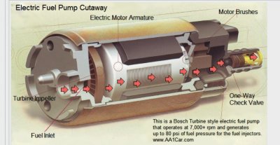

Plus, look at the path the gasoline take in a fuel pump.
The gasoline passes over the areas where the heat is generated.
