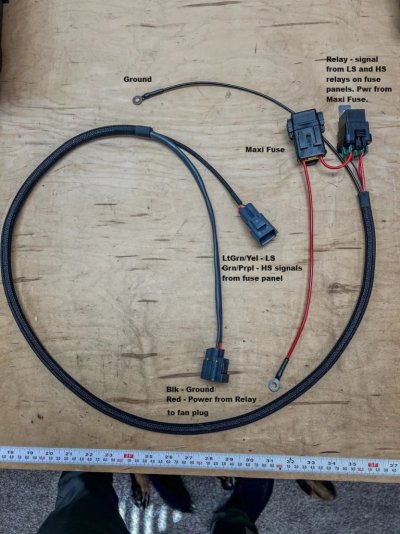

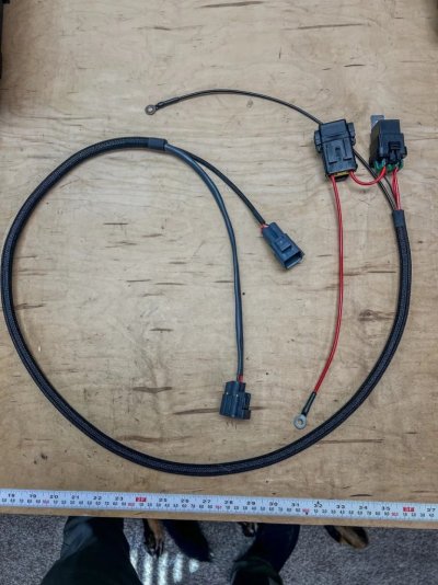

Great post. I’m n my 3rd now. I’m going to buy the kit below next.
crjackson
Nov 28, 2015
615
313
Midgard
Nice touch to include the extra ground. Always felt that was an issue with the design. This should help a lot of owners.
It’s an awesome and needed mod. I’m going to order one after the new year, and just have it on hand. It will go again, and I’ll be ready. If it doesn’t burnout again soon, I’ll go ahead and install it preemptively.
