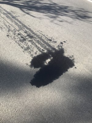

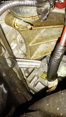

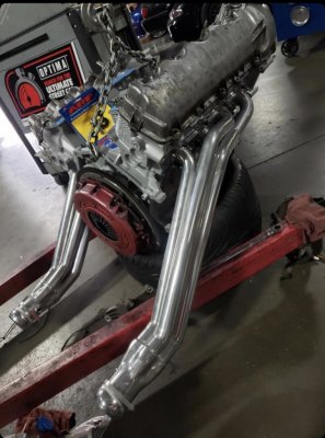

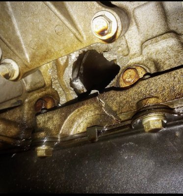

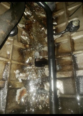

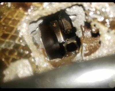

Honestly, the short block was put together in an emergency situation, I threw the rods out of the stock block 7 weeks before moving cross country. So I don’t know exactly what parts were used as far as rods/pistons/rings, I just found a used block and had L&R in Santa Fe Springs, CA build what he saw fit. I do know the builder used ARP everything, upgraded the oil pump, and lowered compression a bit from 9.8 to 9.5 for the boost. Under different circumstances, I’d probably have opted for a Coyote swap.
Junkyard block was $800 iirc, and he built it for around $5500. This was almost 4 years ago

Fu....., God man; so sorry. What a tragedy. Who was helping you tune it?
On the bright side (if you can afford it); you now have a great excuse to go for a Coyote or GT500 build.
