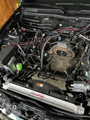

New here but long time stocker, I blew the bottom end of my 4.6 5spd and currently trying to remove the engine and trans as 1 as I heard this was easiest but it seems to be stuck, the trans that is. I have undone the 4 bolts to the drive shaft but was not able to disconnect the driveshaft and trans with limited jack room, and I undid the 1 bolt on the trans k member and both nuts that seem to connect to the trans, I’m wondering if I need to drop the entire k member, and if I must first physically disconnect the drive shaft front the back of the trans, I know there are 1000s of forums on this I’m sure but I can’t seem to find specific answers to these questions, and being my first engine pull at 20 I’m kinda lost, the engine wiggles around but won’t come forward. Thanks for any advice.

The engine will come out with or without the trans. Its easier without. You definitely need to disconnect the driveshaft. I'd take off the trans mount too. Plus the clutch line. The trans is a tight fit on tunnel. So you'll need to drop it down first then move the engine forward and up. Lowering the k member doesn't get you much but it doesn't hurt either. You can drop it about an 1" without removing the bolts completely.
You may run out of height with the cherry picker to get the trans out over the radiator top mount. If so, you'll need to lower the car to get the trans to come out.
Remove the radiator. Unbolt any remaining a/c condenser mounts. Push it forward for clearance and not to damage it.

I’ll lyk about the parts once I get it torn apart man, plus ok it sounds like I should be just pulling the engine for now, is there really any tips to separating it from the trans beside 7 bolts shouldn’t be much more correct? Just use a pry-bar and evenly try to get it off?

As long as the trans and motor are each both fully supported, you shouldn't have any problem. The dowel pins that align the trans to the motor can be a little stubborn but a little shaking and pulling will probably do the trick, but you may need a little help with a pry bar. I had my trans out a few months ago and separating them was fairly easy. Mating them back together was difficult.

Don't take all the bellhousing bolts off. Leave 2 or 3 in, that are 1/4" loose. Wiggle and pry the trans loose. It will come apart.
To make everything much easier, make 2 alignment bolts. Figure out the metric bellhousing bolt size and then buy 2 bolts that size but 4" (100 mm) long. Cut the heads off. Then grind about 3/4" down to a taper (not the threaded end, the end where the head was). Thread these into the bellhousing.
As you get the trans loose, keep loosening the 2 remaining stock bolts. Eventually the last 2 stock bolts come out and the trans slides off on the 2 alignment bolts. This takes the load off the pilot bushing and the clutch disk. And it will make reassembly much easier.
