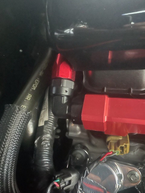

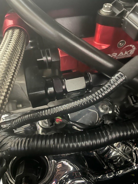

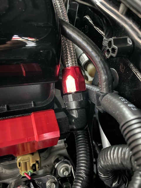

When I did this project awhile back, I used Russell Performance Fittings and the Fore Fuel Rail Adapter. There was some trial and error trying to find the right angles and fittings to match the Scott Drake fuel rail line, but I got it done. See pics below:
F1 by Tony Cruz, on Flickr
F2 by Tony Cruz, on Flickr
F3 by Tony Cruz, on Flickr
