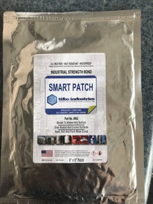

? What metal did you replace w plastic?
Just a 4 inch section in the lower rear quarters. Have monitored regularly ever since. No flexing/cracking issues felt/noted or evident. Of course, in my case I also added frame connectors front so that could be a factor mitigating any flexing vulnerabilities.

sorry I'm still confused - could you explain a little more, maybe a photo? I just can't gt my head around replacing sheet metal with plastic anywhere on this car, even though I do like the concept

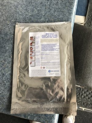

Sure, it's a UV cured fiberglass reinforced polyester product that is flexible/moldable until you hit it with UV light so don't try to put this on in sunlight. Actually, quite strong and going on over a year now; no issues at all. My body guy ran across it and as an experiment repaired both of my cars with it. Amazing product. Really happy with the results. Sorry the second page of instructions are out of focus.

Detail above....
