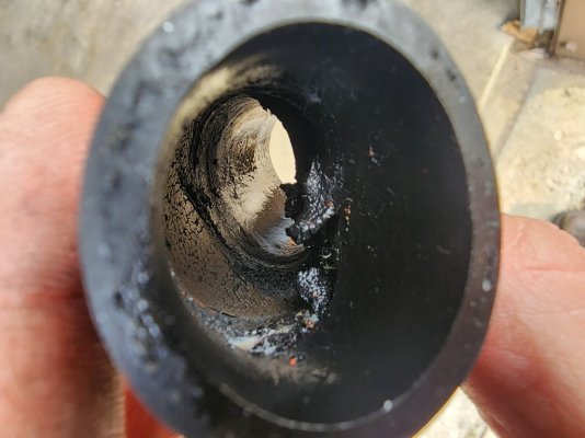

Check all of your coolant lines inside and out as well, if Temps got over 3/4 on the gauge you could have the same problem as I've been tracking down.20240325_153449.jpg
