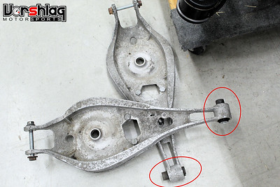

SPHERICAL BUSHINGS
On the upper arms there are rubber bushings on the inboard side. Rubber bushings are the Devil - they allow lots of deflection under lateral and braking loads, which we don't want. So we invested in these Rogue Engineering spherical bushed housings for this location, shown below left.
View attachment 78840![](/proxy.php?image=https%3A%2F%2Fphotos.smugmug.com%2FProjects%2FTeam-Vorshlag-E46-Endurance%2Fi-cdXV49m%2F0%2Fd0f90dd1%2FS%2FIMG_8672-S.jpg&hash=4f632e4844cae1a6ec4dfea63bff9267)
Tim used some sockets and the 20 ton press to push out the old rubber bushings and housings, then used an old mechanic's trick - tossed the Rogue spherical housings in the freezer for a few hours.

That shrinks up the bushing and allows it to slide into place in the upper control arms nicely.

The Rogue housings have a face on one end that you press to the control arm. The other end has a groove for a snap ring, which secures into the arm. Inside this housing is the spherical bearing, with bushings that press inside that to allow the bolt to fit and provide articulation. Above right is this end of the re-bushed upper arm bolted into the E46 M3 subframe.
