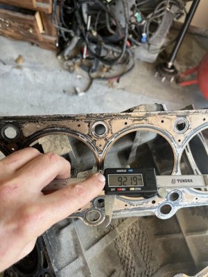

I still have the stock head gaskets on the block and they do feel alittle bigger than the hole but it’s really close. Prob take them to engine builder and see what he says after bore. I’ve been looking for a range the stock gaskets will cover but just keep finding this kinda info

Measure them. I used them with 3.572" bore diamond pistons 0.020" as thousands of others have.
I have 2 sets still sitting on my wall and the bore measures around 3.63" on all 4 of them.

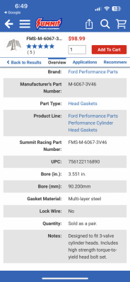

Didn’t see any stock gaskets in link but found a few sites lastnight saying the OEM gaskets would cover .030 bore so ill get’m ordered. Thanks all..will have head bolts for sale for cheap if anyone’s interested, got head studs and can’t seem to find the OEM gaskets without head bolts
Measured. Not sure what it tells me really but the summit link shows 90.20mm bore and I got 92.19…so it should work. This is not an accurate way to measure by the way, gauge kept jumping around as it slipped around hole but held this measurement for awhile. Ordered stock replacements the other day…just wanted to follow thru!!
