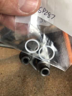

Unfortunately, those part numbers didn't work. As you can see in this picture, they are way too big. They look like the Dorman o-rings I had originally purchased

So, I just ended up buying a new hose, as a quality aftermarket version was only $21. That satisfied the larger o-ring requirement, since the new hose came with rings.
That smaller one though - it is a small, metal "L" tube that has been discontinued. On ebay and such, it is $50-$60. The o-ring is part #3L2Z3F886BA. That's probably the way I'll go there. Unfortunately, the cheapest I've found is nearly $12.
Is what it is.

Those are the lines at the rack... your original post said for the power steering pump, the part # I gave you is for the hard line at the pump.
1950StangJump$
Apr 1, 2010
966
108
Okay. But, I'll take the blame for a bad description.
But, there is only one screw-in, NPT type fitting at the pump that would need an o-ring; the other on the pump is the hose/clamp fitting.
So, that would explain one of the part numbers you listed. What was the other?
