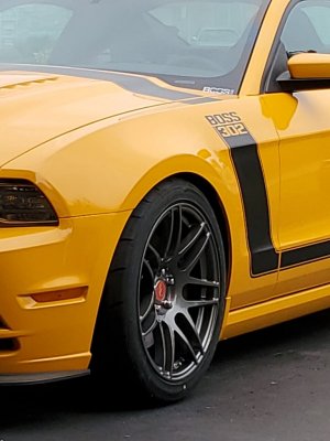

Newbie to this Forum so if this has been posted in the past I sincerely apologize. I own a 13' Boss with a few suspension mods that have dropped my ride height approximately 1.25". I purchased a set of Forgestar F14s. 10" +42 for the rear. I really want a deep concave on all four corners so I went 9.5" +29 for the front. Has anyone run the +29 with a 265-40-19 upfront. I know a lot of guys run the 9" upfront but in the Forgestar but that's semi-concave (+35). Any feedback or pics would be greatly appreciated if your running the 9.5" THANK YOU

You've moved your front rims outboard about 1/2", are running 265 vs 245 tires and have lowered car 1.25". Good chance you are going to have interference with fender unless you add camber plates and 2 degrees of camber.

Running 285-35-19 on 4 corners Forgestar 19x10 +42 o.s. with no issues. Had to run a 5mm spacer in the front to clear Brembos. Also running BMR lowering springs. Good fitment

I run SVE R357's 19x10/11. I run a 265/40 on the front. Its a 28" tall tire and im lowered 1.5 inches all the way around.
Front specs are
Backspace: 6.88"
Offset: +35mm
