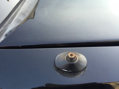

Need a bit of help. My antenna broke and I tried to drill it out, but it seems like the mount's threading is rusted to hell. Anyone ever had this issue or have an install guide on the mount? (08GT)

Pry the cap off, remove the 3 screws, lift the mount, unplug the wire, reverse the procedure with the new one.

Thanks so very much. Now i need to find the base. Mine is pretty much shot!
