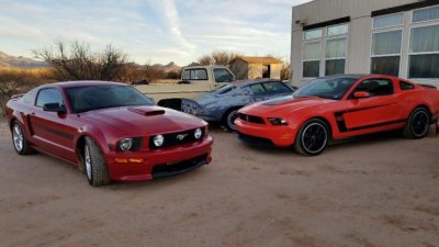

Hi. I bought my already modified '08 GT 2 years ago after losing my totally stock (except for CAI) '08 GT in a deer collision. After haggling with the insurance company for a month (they wanted to settle for $9,500, finally agreed on $12,500), I picked up a beautiful super low mile (2.6K miles) '12 Boss 302; factory cover, factory owners manual, factory smell, etc., but I wanted another 4.6 so the next weekend I found a beautiful '08 GT/CS in Scottsdale at a Ford dealer. Apparently the owner had purchased it new, spent a ton of money on a CAI, Hot Rod cams, FRPP shorty headers, Ford lowering springs, and GT-500 muffler, then passed away. His wife kept it in the garage for years until someone convinced her she needed to sell it. I picked it up with 29K miles. When I started it up for the test drive I was blown away. I love my Boss (my wife does too), but nothing compares to the idle of a 4.6 with Hot Rod cams. I replaced the Ford shorty headers with BBK long tubes and also went with the BBK high flow cat mid-pipe. Charger guys in the line at the car wash drool over the idle and I'm constantly getting, "I wish mine sounded like that". In response to 'Aero' I don't have a lot of the problems he's mention. I don't have any smell, it seldom bucks, and it's perfectly happy in traffic although you can tell it's not a stock 4.6. I have a 2 hour daily commute and it's my daily driver, 20K miles per year. I set the cruise at 70, put some tunes on, and sit back and enjoy the trip. Boss and GT-CS.jpg

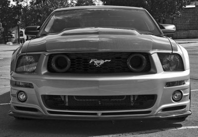

... perfectly happy in traffic... View attachment 81079
Good review! I'm just spoiled with the S/C, the cams and all the bolt-ons still don't get close, IMO, two completely different outcomes, that said, motorheads love the cams! I admit, I've always been into having a unique (and of course very subjective) look and still fast vs loud and fast.
Clarification, NEVER said bucking! I meant the ability to more easily creep through a parking lot unnoticed and compared side-by-side, some drivability is lost, however minimal.

Hi. I bought my already modified '08 GT 2 years ago after losing my totally stock (except for CAI) '08 GT in a deer collision. After haggling with the insurance company for a month (they wanted to settle for $9,500, finally agreed on $12,500), I picked up a beautiful super low mile (2.6K miles) '12 Boss 302; factory cover, factory owners manual, factory smell, etc., but I wanted another 4.6 so the next weekend I found a beautiful '08 GT/CS in Scottsdale at a Ford dealer. Apparently the owner had purchased it new, spent a ton of money on a CAI, Hot Rod cams, FRPP shorty headers, Ford lowering springs, and GT-500 muffler, then passed away. His wife kept it in the garage for years until someone convinced her she needed to sell it. I picked it up with 29K miles. When I started it up for the test drive I was blown away. I love my Boss (my wife does too), but nothing compares to the idle of a 4.6 with Hot Rod cams. I replaced the Ford shorty headers with BBK long tubes and also went with the BBK high flow cat mid-pipe. Charger guys in the line at the car wash drool over the idle and I'm constantly getting, "I wish mine sounded like that". In response to 'Aero' I don't have a lot of the problems he's mention. I don't have any smell, it seldom bucks, and it's perfectly happy in traffic although you can tell it's not a stock 4.6. I have a 2 hour daily commute and it's my daily driver, 20K miles per year. I set the cruise at 70, put some tunes on, and sit back and enjoy the trip. View attachment 81079
Awesome review! Now with all those mods, how does it compare with your Boss? I'm sure the Boss pulls much harder, but would be interested to hear how much different (or the same) they are.
