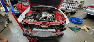

Jul 29, 2022 #3 1 1ohiostang Junior Member Joined Jan 16, 2011 Posts 40 Reaction score 11 I have a 2200 also. Mine is mounted in the pipe coming off the blower before the intercooler. There is a spot behind the front bumper cover with enough room for it
