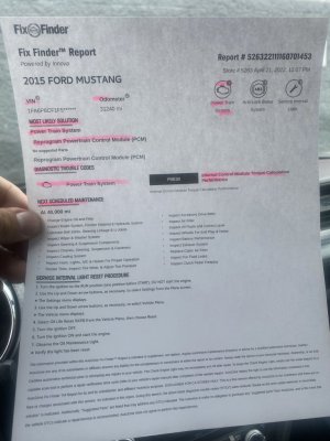

So I went to autozone real quick to get it diagnosed. Here’s what I got

Now that is an iteresting pcm code. No hard faults, but the pcm thinks the engine is making more power than it should. Leads me to think there is a tune on the car, not factory stock.
Yes I had come across that one personally on mine. In my case, I suspect my tune got corrupted.
Autozone cannot scan the ABS module, where the advance trac is.
