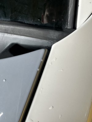

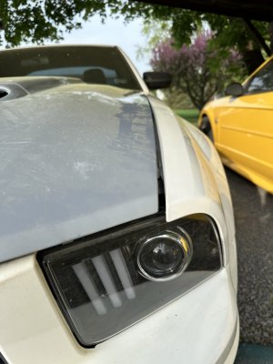

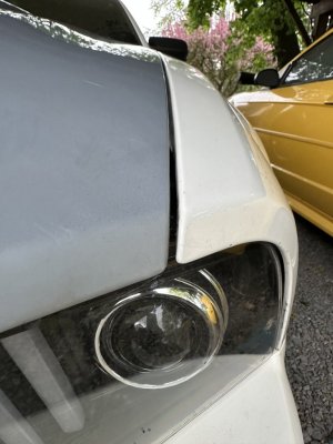

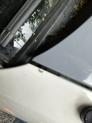

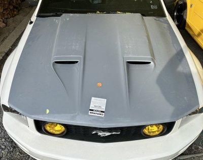

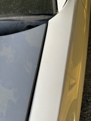

I just purchased a Cervinis Mach 1 hood which was delivered last week. So the other day I was test fitting the hood on my car before giving it to my body shop guy and the pictures below show how well it fits…or not as the case may be.
I cannot seem to get any more adjustment out of the hood hinges/mounting holes. Is there something I’m missing or was this hood made out of whack?
I’m hoping someone has an idea as to what might be going on here. I messed around with this hood for over two hours and can’t seem to get it to align any better. For $800 plus shipping, I expect, no demand, a better product.

Thanks, I have not loosened the fender bolts as of yet. Didn’t want too many variables before I understood what was going on.
Yes, the hood needs to come forward on and move towards the driver’s side, like a right hand twist. But there is no adjustment range left in the hood hinge bolt holes. I thought about enlarging them with a step bit to get more adjustment range.
The OEM hood fits very well as is, I was hoping this hood would as well.

It's common practice at autobody shops to tweak the hinges in order to make the hood lay as close to correct as possible. That's the first thing you do. After you've got all you can from the hinges, you start moving the fenders. If you end up moving the fenders, just barely loosen the fender bolts and tap the fender with a rubber mallet. I don't know if that hood will be stiff enough to tweak the hinges. You may need to install the original hood to get the hinges to cooperate, then put the new hood back on.

Appreciate the responses, I’m not much of an auto body guy, I’m more mechanical. I’ll try to get the fenders tweaked.
A few questions:
Is there any merit in enlarging the hinge to hood mounting holes?
Can the hinge to fender bolts be tweaked to get some adjustment there?
Thanks again!

The best/most adjustments are to be had in bending the hinges. You just open the hood enough to grab each side in the front, and push the hood the direction it needs to go. I've done this procedure at least a hundred times. If the entire hood, not just the front, needs to move to the drivers side, you'll need someone to push on the back end of the hood in the desired direction while you push on the front. This is how hoods have been aligned at the manufacture since the advent of hinges. From the pictures it looks like your hood needs to move about 1/16 in the back and 3/16 in the front.

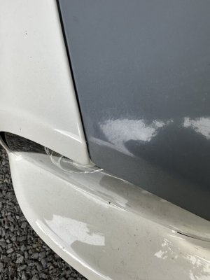

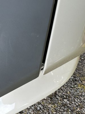

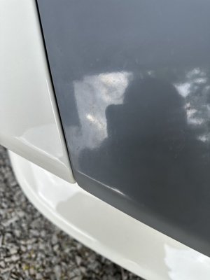

MrBhp, thank you for the suggestion. I searched and searched looking for helpful tips like that and couldn’t find it anywhere.
I put the OEM hood back on and did as you suggested, got a little bit of movement. Took that off and very slightly bent each hinge the way I needed it to go. Put the fiberglass hood back on, it’s a lot better but not exactly where it needs to be. Almost need both entire hinge assemblies (about the center point, looking from the top) to twist to the right a little bit.
I also loosened the fenders up and shifted them, but didn’t really get much adjustment.
Thinking I might step out the mounting holes a little to be able to shift the hood a bit.
The right side needs to move to the right about 1/8 at the back and maybe come forward a 1/16 to 1/8 at the front. The left rear at the back needs to move to the right about 1/8. Just had a thunderstorm move in so, I’ll have to get back to it later.
Here is some updated pics. Thank you for all the suggestions.

Well…I think was able to get it adjusted about as far as I’m going to, especially since the body shop will need to take it off for paint. I think the rest of the necessary adjustments can be found in tweaking the bolts securing the hood to the hinges.
My son and I spent the morning loosening and adjusting the hood hinge to inner fender mounting bolts. We also got a little bit of tweaking out of the fenders. Never would have thought this would be a family project with my wife and son over several days. LOL. Probably spent a good 6 hours on this.
Updated pics below. You can see it’s still a little too close to the RH fender at the front.

There is NOTHING wrong with your new hood it's the way the Mustang is built, not one leaving the plant are exactly the same. Adjustments to fit are 100% normal. I'm so anal it took me 10+ hours to get my Cervinis 2000 Cobra R hood aligned on my 1996 GT. And I know for a fact my 1996 has never been in one accident.
On the S-197 If you remove both front fenders you can access the hinge to body bolts. And that's the ONLY way you can access that one bolt on the hinge to body. But you really should not have to do that, but it is possible.
Your doing great on the adjustments. I would loosen the passenger side fender and pull it away from the hood up by the headlight a bit more. Remember the hood moves when driving down the road you don't want that freshly painted hood touching the fender at all.
Also, You can have the body man shave off some material off the hood to get that perfect fit if need be.
