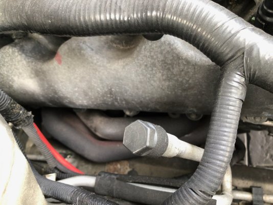

Well, I almost have tackled this project completely yesterday however, before I starting tightening things down with a torque wrench, I needed to double check some things with everyone here.
Fitment - Drivers side is absolutely perfect. Passengers side, close. Has anyone had an issue with any brand of header barely touching the passengers side floor pan? Actually the heat shield which is just above the collect now with the LT’s. It still has room to go but as I installed it with the motor supported up, the header didn’t want to go until I practically lowered the motor enough to mount the motor mount. I ended up having to do just that to make everything fit correctly. On a side note, I’m wondering if the chassis being on jackstands is binding them slightly?
Anyone have any pictures of their installs?

Update to my question, I obviously should have looked above the heat shield to realize it wasn’t touching the car so therefore, the header isn’t touching the car which is good. In theory I could remove the heat shield but I have decided on what to do with it yet. I’ve attached a picture for reference to show the room I’m talking about.
