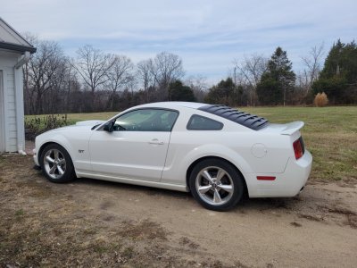

This is how mine sits. (The louvers are not attached...just checking the look).
Stock wheels 18x8.5
Tires are 255s.

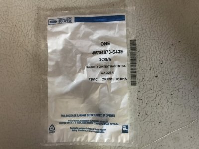

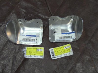

Here ya go.........................
The advent of the heat shields on the front lower control arms came via of this Ford issued TSB starting w\ 2011-2013 MY provided below:
All warranty replacement FLCA's came w\ these heat shields as Ford determined from failure analysis that the rear hydro bushings failures were heat-related (the OEM cats reside very close in proximity to the rear FLCA hydro bushings......as they do on all 05-14 GT's). They were later added as std equipment for all '14 MY S197's (I checked thru www.fordparts.com & the only MY these showed up as a replacement part was 2014 MY).
Here's the Ford part# for the self-tapping heat shield bolts (they come in a 4 ct-pack only, so you have to buy 2 of these) & the Ford part# for the heat shields are visible in the picture. They are side specific (L-R).
I ordered all this thru my local Ford dealership at the time...............yes, these bolts costs more than the shields.
The Ford Performance M-3075-E GT500 FLCA kit I bought for my '09 GT came w\ the OEM heat shield mounting tabs on the rear hydro bushing housings.
Hope this helps.

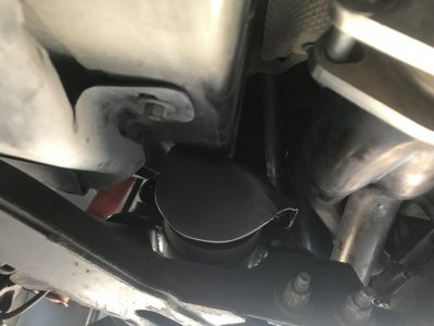

PS edit (2-25-23)-- Here's pictures of the heat shields on my '09 GT:
14 FLCA Rear Bushing Heat Shield DS.JPG 14 FLCA Rear Bushing Heat Shield PS.JPG In the end to each their own, but when Ford sends out a TSB & designs a remedy on a part issue that is a common part design on any MY S197, the failure is just as prone to happen on any MY of these vehicles, so I installed the Ford remedy on mine for peace of mind........the proximity to heat--thus potential premature failure--is just too great. I replaced my '09 GT's original FLCA's due to finding both FLCAs rear hydro bushings had splits in them causing excessive caster deflection on semi rough roads........wonder what was causing the rubber to break..............
Stock wheels 18x8.5
Tires are 255s.
That's quite a bit lower than mine. If I could get some low mileage stock springs for a song I would replace them when swapping in the Konis. Mine might have settled some with 150K on it but it definitely sits higher than yours. My tires are 275/40-18. I cannot pull my car into my driveway without backing it in.
