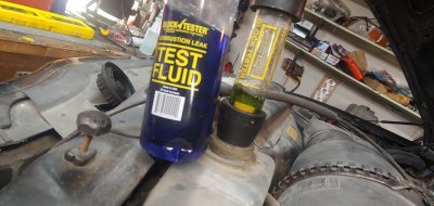

I will be doing a combustion leak test today to confirm its a headgasket. A buddy is telling me exhaust smell in the coolant doesnt mean its a headgasket which I think is BS.... how else is it going to get in there???? The intake is under vacuum, he thinks its getting in from there but I think its not possible unless it was pressurized from a bent valve which would probably blow a hole in the intake.
