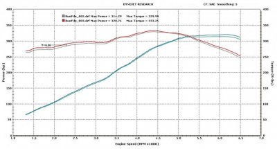

Here ya go:
https://www.andersonfordmotorsport.com/content/exhshoot3.htm
This dyno shootout doesn't include the BBK shorties but you can expect the same 4rwhp from those as you'd get from the Ford Racing headers.
My dyno numbers were before and after installing JBA knock-off shorty headers with results similar to those obtained by AFM above. Torque gains down low were pretty good for such a simple upgrade.

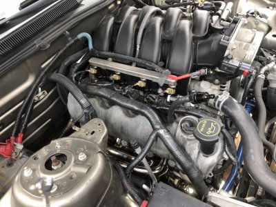

I have BBK shorties on my 05' GT and I had no issues on the install or fitment (others have mentioned steering shaft contacting one of the tubes, gaskets leaking, whether to uses/studs or bolts, etc.). They give a nice sound and the HP increase is marginal.IMG_8457.jpg IMG_0652.HEIC.jpg IMG_0722.HEIC.jpg
I would have gone LT, but the price that I got them for new in the box it was a no-brainer.

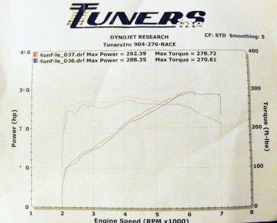

Someone posted on another forum. BBK shorties. P1010512.jpg Avg of 4-5 hp, and 8lb ft of tq.

Someone posted on another forum. BBK shorties. View attachment 86659 Avg of 4-5 hp, and 8lb ft of tq.
That was on an S197 3.7 V6 so there'll be a slight difference, but the torque gains in the lower midrange still hold true though.

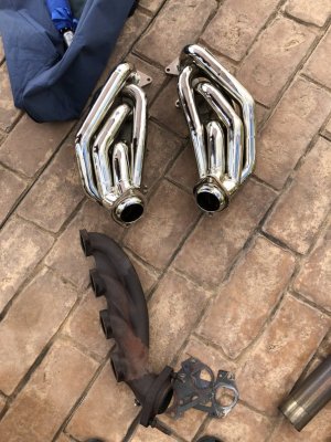

I love when things have a way of working themselves out. cruising a local for sale forum and found a brand new set of bbk shorties, ceramic coated. great priced already, threw him an offer and he took it, picking them up monday.

thank you for all the help especially the dyno results. I ended up picking up a set of BBK ceramic coated for a steal on offer up.
