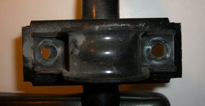

FYI: I installed the 2011+ parts now on my 07. The rear bar is just a bolt on, the front bar is not. The distance between the bolts is on a 2011 larger so I had to grind out the holes in the new mounting bracket; approximately 2 mm each hole. Second, the new sway bar bushings are now pressed on the bar in a fixed position. To mount the sway bar links I had to raise the strut one inch combined pressing the bar down with a piece of wood. Once one link was in place, the other side was no further problem.

An other side effect I noticed: The front suspension has become gentle and quite over bumps now. Probably that is because the sway bar bushing is much bigger than on the 07 and the NVH is lower?

Newer rubber is softer.
