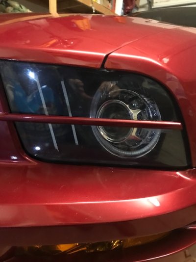

OK boys and girls anyone know if the 2013/14 headlights will fit in the 2005-2009 mustang GT's ? what about the 2010s will they fit the 2005-2009s ?
If you're handy with tools and a heat gun you can build a set yourself. Here's a series of pics illustrating how I did mine. I found everything I needed on Feebay. Think I spent probably $200 on parts (stock headlights; projectors; halo's, mounting system, etc) and about 20 hours work. I ended up changing out the bulb type to a DS2 because it needed to fit within the base of the stock reflector. I also added amber turn signals but didn't use them as the turn signals included with the projectors were fine but I can wire them up anytime I want.
