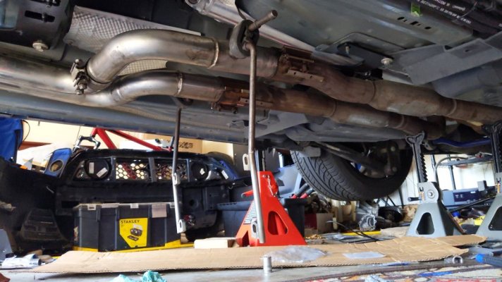

Here is a photo of my turbo car that retains the stock mid pipe section (with the resonators) after the stock "X" merge. A catback would eliminate this as stated because it would bolt after the cats and go all the way to the back of the car.

Thanks all. As stated above I'd plan on putting on a cat-back. Now, let me ask this. I don't want to put on headers, but I'd like to find a midpipe that has high flow cats to update the factory cats. Everything I've found requires the addition of long tubes with a high flow cat setup. I did find one that was magnaflow high cats with tru x setup but it was like $1500. Is there anything else out there?
